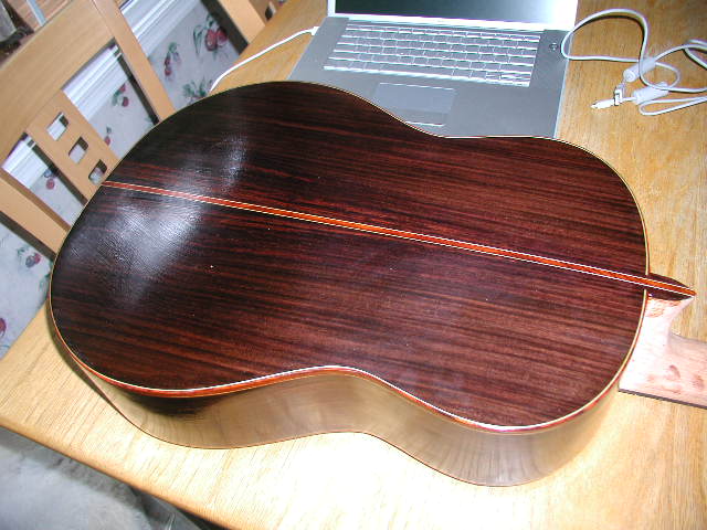

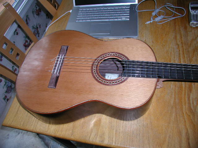

I have had good early success with the Rodriguez plan (GAL) of Tom Blackshear's. This is a very large guitar, though - doesn't fit in a standard classical case, etc. I'm near to finishing one in IR, WRC with a spanish cedar neck and cocobola trim.   Couple of pics here. Still need to finish neck shaping, sand out cooties on top, level sand the Z-Poxy, and FP everything.
This guitar has a standard Spanish heel, and was built following David Schramm's course based on the same plan (never finished). This is the third I've built from this plan.
